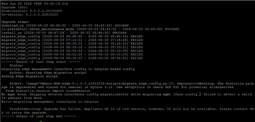

  • When upgrading an NSX Edge from a version earlier than 9.1 to version 9.1, the process fails during the migrate_edge_config step.
  • This issue typically occurs when the Edge was originally installed using the ISO interactive method with a static IPv4 management interface.
    • It applies to both Bare Metal Edge and VM Edge.
  • Retrying the upgrade does not resolve the failure.
  • Below logs will be seen under /var/log/syslog for the error:
    2026-01-12T07:34:30.669Z <hostname> NSX 54603 SYSTEM [nsx@4413 comp="nsx-edge" subcomp="upgrade-bundle" level="INFO"] Script /image/VMware-NSX-edge-9.1.0.0.25318228/scripts/migrate_edge_config.py exited with return code 255
