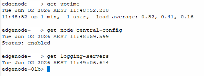

  • The node central-config feature is set to enabled (which is the default behavior). You can verify this on the Edge Node CLI:
    Edge> get node central-config
    <Time Stamp>
    Status: enabled

  • After a reboot, running get logging-server from the CLI shows no configured servers.

  1. Log in to the NSX Edge Node local CLI as an admin user.
  2. Run the following command to disable the node central-config:
    set node central-config disabled
  3. Re-apply your logging server configuration via the CLI:
    set logging-server <syslog-server-ip-address:port> proto udp level info
  4. Verify the configuration is applied:
get logging-server
The configuration will now persist following future Edge Node reboots.
