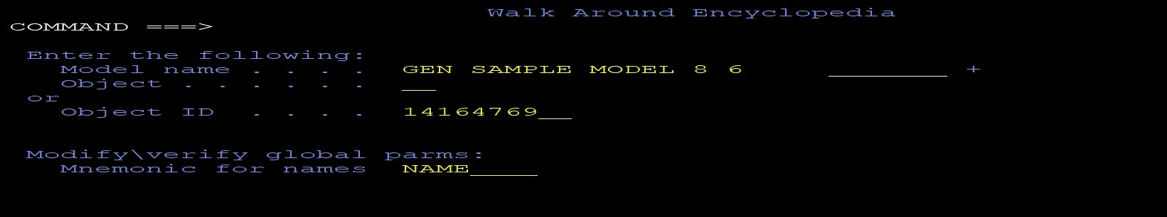

  1. On initial screen enter ACBLKUSE object id into the Object ID field and hit enter:

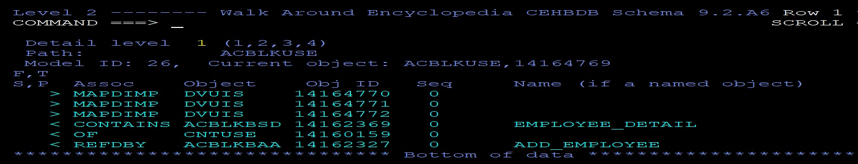

  2. On the next screen the corresponding ACBLKUSE object type should be visible:

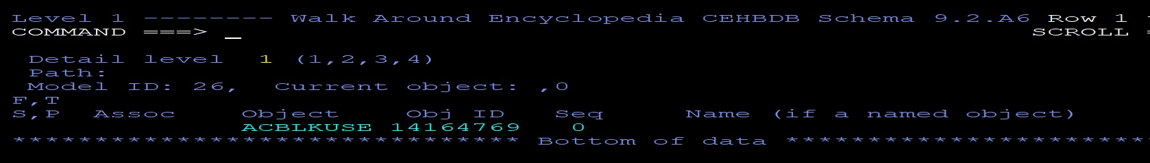

  3. Then use S on the ACBLKUSE line to get to the next screen showing the called action block (< REFDBY ...) and calling action block (< CONTAINS ...):
