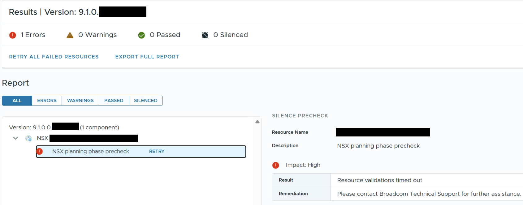

  • In the SDDC Manager UI, the VMware Cloud Foundation (VCF) 9.1 upgrade precheck fails during the NSX planning phase with the following error: Resource validations timed out.
  • Review of the SDDC Manager logs reveals certificate validation and SSL handshake failures.
  • Under SDDC Manager's /var/log/vmware/vcf/domainmanager/domainmanager.log, below error log snips are found:

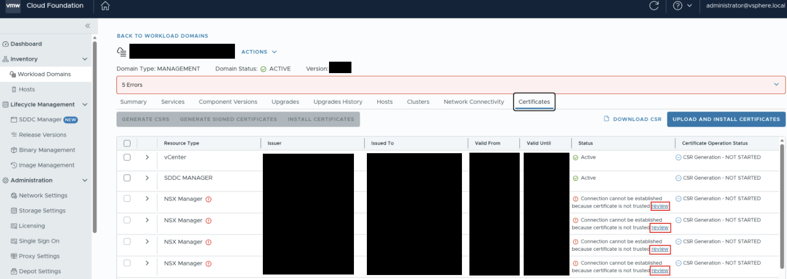

The SDDC Manager database contains an outdated or un-trusted certificate chain for the component resource (NSX Manager). This typically occurs when a certificate is renewed, updated, or imported directly on the resource node (e.g., via the NSX Manager UI or CLI) instead of being managed through the SDDC Manager orchestration interface. As a result, SDDC Manager loses trust in the endpoint, leading to validation timeouts during the upgrade planning phase.
To resolve this issue, manually synchronize and trust the active certificate chain within SDDC Manager:
  1. Log in to the SDDC Manager UI using Single Sign-On (SSO) credentials.
  2. From the left navigation pane, navigate to Inventory > Workload Domains.
  3. Select the Workload Domain associated with the failure.
  4. Click on the Certificates tab.
  5. Locate the NSX Manager Certificate and review its validation status.
  6. Select the option to review the endpoint certificate.
  7. Verify the certificate details and click Trust to manually import and synchronize the active chain into the SDDC Manager database.
  8. Once the certificate status shows as Healthy, navigate back to the upgrade dashboard.
  9. Click Retry on the failed precheck task to proceed with the VCF 9.1 upgrade.
