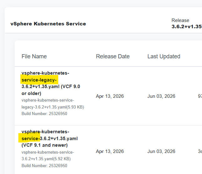

  • When the standard (non-legacy) VKS Service YAML definition is applied to a VCF 9.0 or air-gapped environment.
    • The standard YAML is designed for environments supporting the VCF Software Depot and attempts to fetch the required image from an internal repository (depot.kube-system.svc). Because this internal depot is not available or resolvable in older architectures, it results in registry authentication and name resolution failures.
    • For pre-VCF 9.1.0 deployments, the 'legacy' version of the YAML must be applied, as it correctly directs the service to fetch the image from the external Broadcom repository (projects.packages.broadcom.com).
    • To avoid registry authentication failures, ensure the correct YAML definition is applied based on your VCF version:
      • Legacy yaml (e.g., vsphere-kubernetes-service-legacy-3.6.2+v1.35.yaml): Points to the public 'projects.packages.broadcom.com' instance via its imgpkgBundle. This must only be used for vCenter versions 9.0 and lower, or within air-gapped vCenter 9.1 (or newer) environments.
      • Standard yaml (e.g., vsphere-kubernetes-service-3.6.2+v1.35.yaml): Points to the VCF Operations Software Depot via its imgpkgBundle. This must be used for internet-connected vCenter versions 9.1 and newer.
