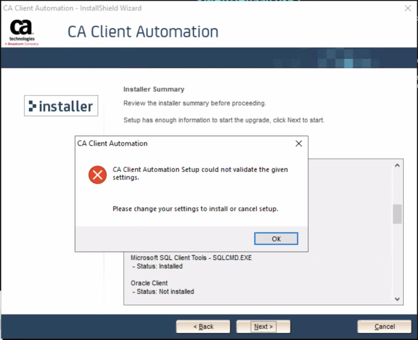

During 14.6 upgrade attempt, the following error appears:
“Could not validate the given settings”
Client Automation 14.6

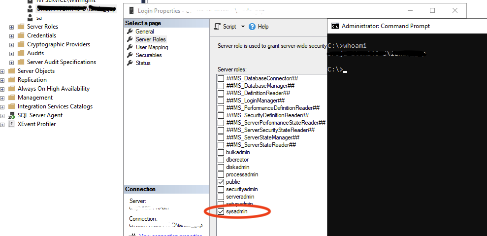

The root cause of this error is that the OS user running the installer has limited permissions on the target DB, the user can remotely login and perform changes in the database (create or delete tables), but is not able to see the DB logins, which causes the mentioned issue.
In order to avoid any error, the recommendation is to grant “sysadmin” role to this OS user, directly in the DB:
After the upgrade ends, the sa permission of this OS user can be revoked, since it's not used anymore.
