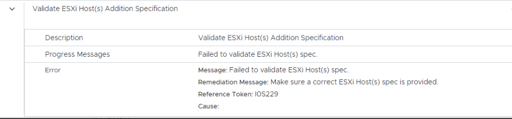

  • When attempting to add a host to the cluster, the API call failed and returned the following error string:
Message: Failed to validate ESXi Host(s) spec. Remediation Message: Make sure a correct ESXi Host(s) spec is provided.
