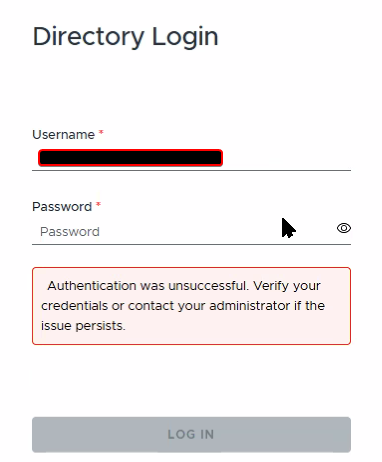

Users are unable to log in to VCF Operations and receive the following authentication error:
Authentication was unsuccessful. Verify your credentials or contact your administrator if the issue persists.
This issue prevents users from accessing the VCF Operations UI even when valid credentials are provided.
