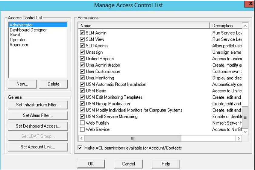

2. In Infrastructure Manager, navigate to the distsrv probe on the Primary hub.
3. With the distsrv probe selected, press "Ctrl-P" the probe Utility (pu) should appear.
4. In the probe commandset, select callback set_acl_init with the parameter value "base_acls.cfg". The callback updates the security.cfg with the ACLs, it will not delete any ACLs, nor change any ACLs.
5. In theIinfrastructure Manager, open Security -> Manage Access Control List. Check to make sure the ACL has USM Monitoring Configuration Service, USM Edit Monitoring Templates and USM Edit Monitoring Station Groups,
6. Logout, and log back in with the user, the issue should now be resolved.

In IM, check that the USM/OC Monitoring ACLs are now displayed in the ACL list by selecting Security->Manage Access Control list from the IM drop-down menu.
Log off and Log in again in UMP/OC.
The monitoring tab should now be displaying for 'USM' servers or groups as depicted above.
