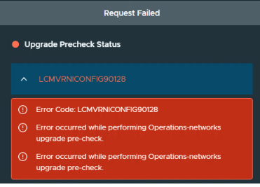

When attempting to upgrade VCF Operations for Networks (formerly vRealize Network Insight) from version 6.14.2, the process halts at the "Upgrade PreCheck Status" stage. The system returns the following error:
com.vmware.vrealize.lcm.plugin.core.vrni.common.exception.VRNIUpgradeCheckStatusException: Error occurred while checking upgrade pre-check status with IP <node_ip> Pre-check message : { "msg" : "HBase or HDFS is unhealthy.", "type" : "INFO", "status" : "FAIL", "id" : "HBaseHdfsHealthCheckTask", ... }
This error occurs even when the underlying HDFS/HBase services report as healthy and disk space is sufficient.

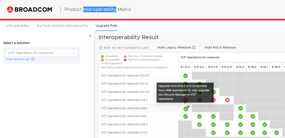

This issue is caused by an unsupported upgrade path. Attempting to upgrade directly from version 6.14.2 to 9.0.2 is not a supported path. The upgrade process triggers a pre-check failure due to version incompatibility, even if the HDFS/HBase services are technically operational.
To resolve this issue, you must perform the upgrade to version 9.1.0.
Prerequisites
Upgrade Steps
This upgrade must be performed via the Lifecycle Manager in VCF Operations.
Note: Upgrading from 6.14.2 directly to 9.1.0 is blocked when using the standalone vRNI/AON user interface. You must initiate and manage this upgrade through the Lifecycle Manager suite.
The only option to upgrade to 6.14.2 to 9.1.0.
