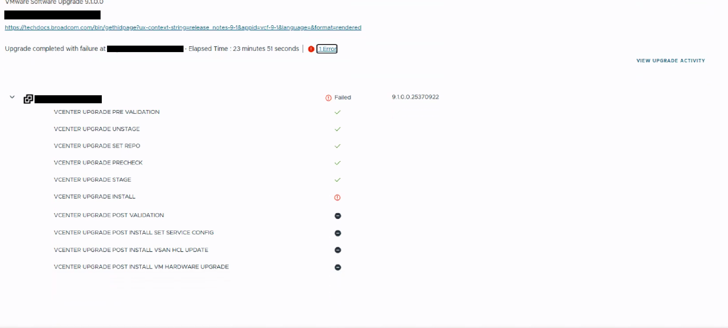

  • SDDC UI > Upgrade Activity shows vCenter upgrade to failure at "VCENTER UPGRADE INSTALL" stage.

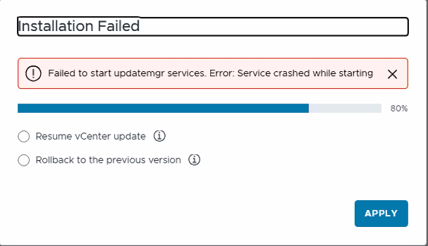

  • VAMI UI shows installation failure along with error message that reads, "Failed to start updatemgr services. Service crashed while starting"
