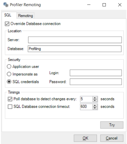

Configure a SQL connection for Altiris Profiler
Altiris Profiler requires a SQL connection to store internal profiler data. This database:
  • Does not need to be the Workflow Solution database
  • Does not need to be the Process Manager database
  • Can be any accessible Microsoft SQL Server database, hosted locally or remotely
  • May reuse the Notification Server database if preferred
To configure the connection:
  1. On first launch, enter the SQL Server name and database.
  2. Validate the connection.
  3. Save the configuration.
