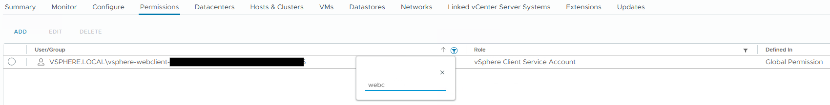

Permissions got inadvertently set prior to the upgrade, or as part of the upgrade process causing the account to be set to read only level permissions.  Since vCenter works under the most restrictive policy those read-only permissions override the normal set permissions.
  • Log into the vSphere Web Client and go to the hosts and clusters view.
  • Click the Permissions tab and search for the vsphere-webclient user and confirm the permissions assigned.  (Should be Role: "vSphere Client Service Account"  Defined in: "Global Permission")
  • If they show anything else, the permissions will need to be corrected.
  1. Take a snapshot of the vCenter to make sure you can roll back if needed.
  2. Select the vsphere-webclient user and remove it from the Permission tab from the vCenter server object.  It should revert back to the correct Global Permissions.
  3. Once the permissions of the account are correct the system should be able to register properly and the UI will show the LCM correctly.
