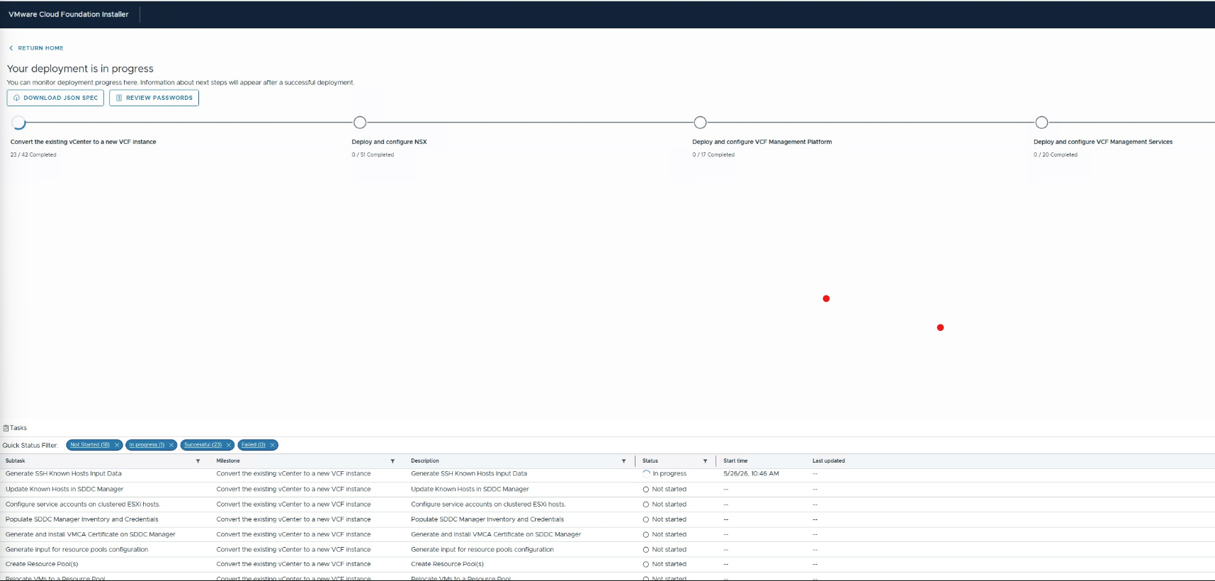

VCF 9.1 deployment is stuck during the "Convert the existing vCenter to a new VCF instance" milestone, specifically hanging on the "Generate SSH Known Hosts Input Data" task.
Article ID: 442379
VMware SDDC Manager / VCF Installer
  • The VCF Installer UI shows the task "Generate SSH Known Hosts Input Data" indefinitely stuck in an "In progress" state
  • Deploying VCF and after pre-check the deployment is stuck at this step:  "Generate SSH Known Hosts Input Data" and Convert the existing vCenter to a new VCF instance 23/42
