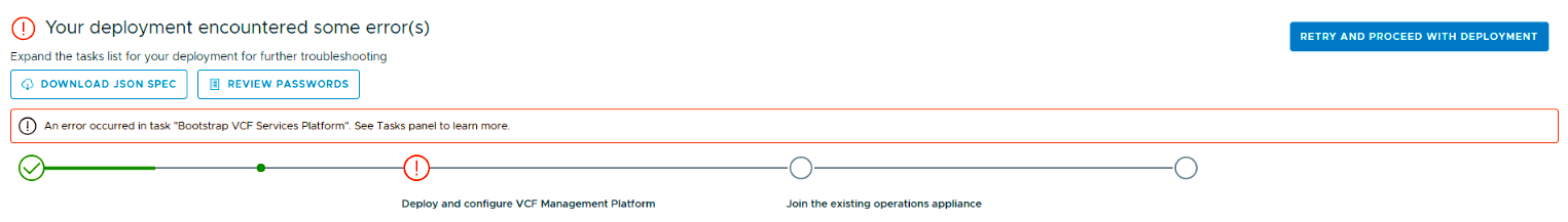

VCF-VVF 9.1 brownfield installation fails with error: An error occurred in task "Bootstrap VCF Services Platform" when a VCHA adapter is present on the imported vCenter VM
Article ID: 442355
VMware SDDC Manager / VCF Installer

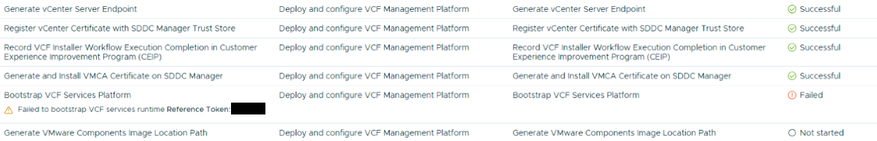

  • VVF 9.1 brownfield installation fails at step Deploy and configure VCF Management Platform with error:  An error occurred in task "Bootstrap VCF Services Platform":
VCF 9.1.x
VVF 9.1.x
Clusters that use vCenter High Availability (VCHA) are not a supported configurations to Converge to VCF.
Remove VCHA configuration from the imported vCenter.
Make sure that the VCHA network adapter is also removed from the vCenter Virtual machine
