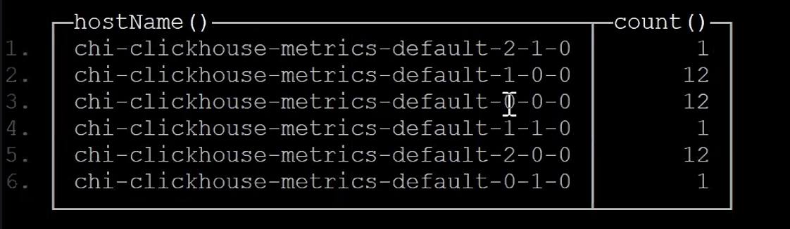

4.) Perform a count of the system.roles and system.users across different clickhouse pods.
select hostName(), name from clusterAllReplicas('default', system.roles) group by hostName(), name order by hostName(), name;
select hostName(), count() from clusterAllReplicas('default', system.roles) group by hostName();
select hostName(), count() from clusterAllReplicas('default', system.users) group by hostName();
If you see an inconsistent count across the clickhouse pods then that's indicative that you are affected by issue in this KB.
Example:
