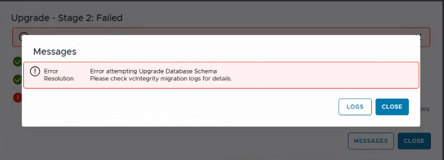

  • When upgrading vCenter Server from 8.0 U3x to 9.1.0.0, the process fails during the vcIntegrity import phase while attempting a database schema upgrade.
    Error attempting Upgrade Database Schema
    Please check vcintegrity migration logs for details.
