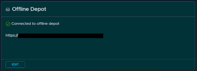

Upon reviewing the Offline Depot connection, it will show as connected:

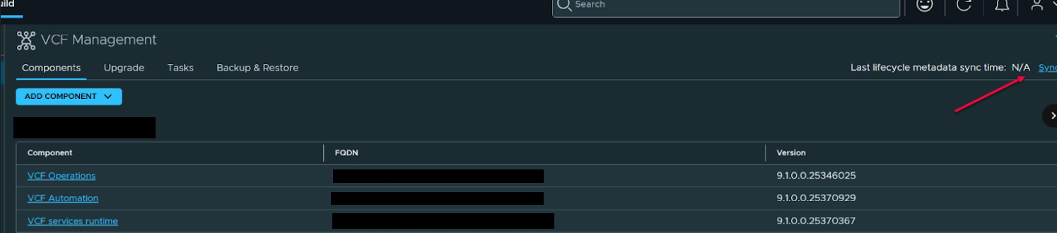

When reviewing the "Last lifecycle metadata sync time", it will show as "N/A":
