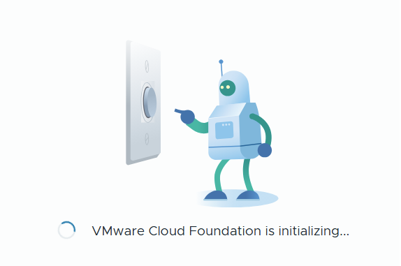

SDDC Manager is inaccessible during upgrade from VCF 9.0.1 to 9.1

YYYY-MM-DD -ERROR SDDC-MANAGER-UI-APP 31382 - [services/wrappers/requestPromiseWrapper.js, init-pscs-primary, logAxiosError:56] axios.error.response.status {"status":500}
YYYY-MM-DD -ERROR SDDC-MANAGER-UI-APP 31382 - [services/wrappers/requestPromiseWrapper.js, init-pscs-primary, logAxiosError:57] axios.error.response.headers {"headers":{"cache-control":"no-cache, no-store, max-age=0, must-revalidate","connection":"cl
ose","content-type":"application/json","date":"Sat, 23 May 2026 11:38:17 GMT","expires":"0","pragma":"no-cache","server":"nginx","x-content-type-options":"nosniff","x-frame-options":"DENY","x-xss-protection":"0"}}
YYYY-MM-DD -ERROR SDDC-MANAGER-UI-APP 31382 - [services/wrappers/requestPromiseWrapper.js, init-pscs-primary, logAxiosError:58] axios.error.response.data {"data":"Failed to establish SSH session to [VC-FQDN] as the host key valid
ation failed"}
