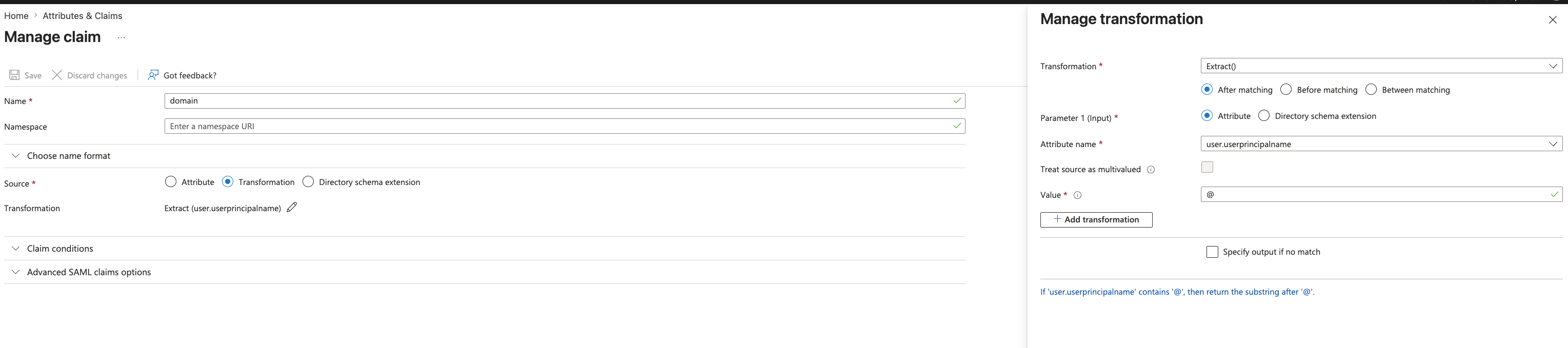

  4. Add a new claim domain:
    • Name: domain
    • Source: Transformation
    • Manage transformation:
      • Transformation: Extract() , select After matching
      • Parameter 1 (Input): Attribute
      • Attribute name: user.userprincipalname
      • Value: @

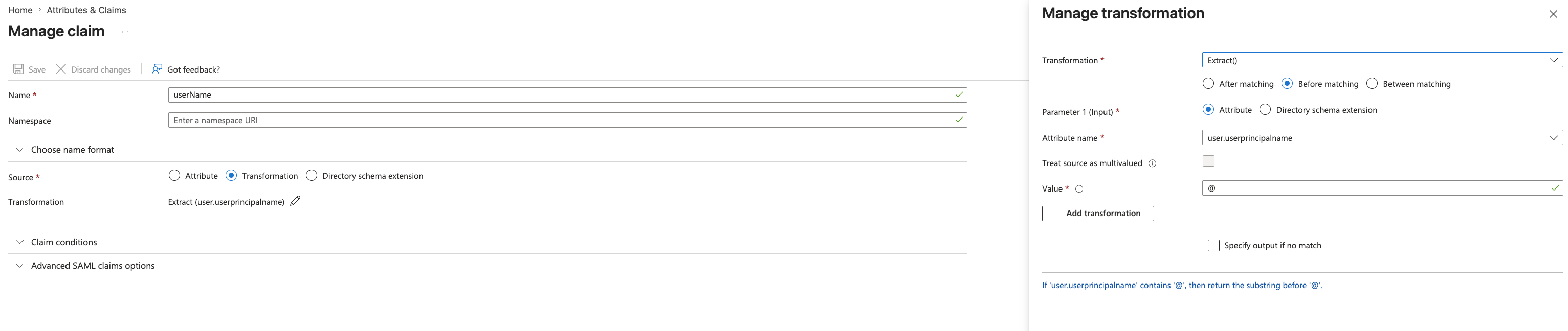

  5. Add a new claim userName:
    • Name: userName
      • Transformation: Extract() , select Before matching
      • Value: @

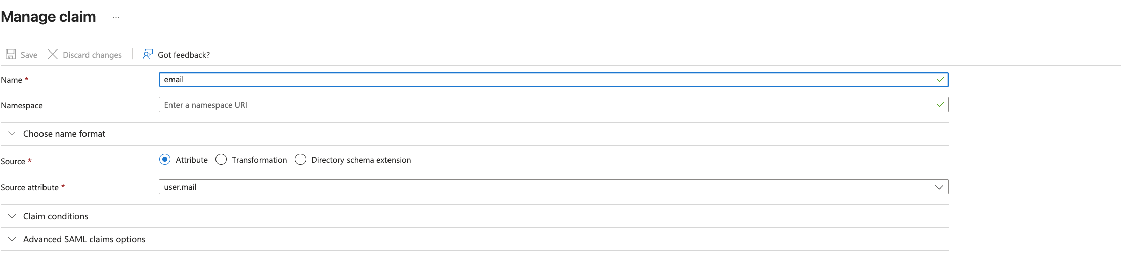

  6. Add a new claim email:
    • Name: email
    • Source: Attribute
    • Source attribute: user.mail

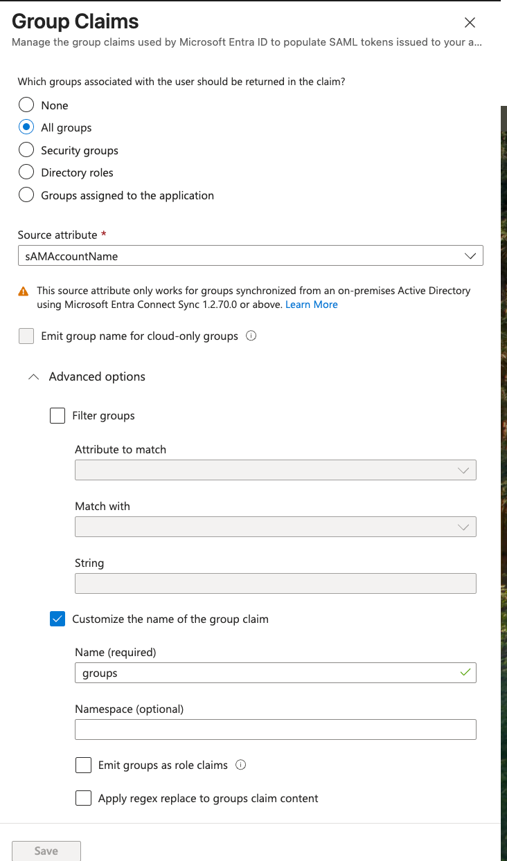

  7. Add a group claim:
    • Select All Groups
    • Source attribute: sAMAccountName
    • Select Customize the name of the group claim
    • Name (required): groups
