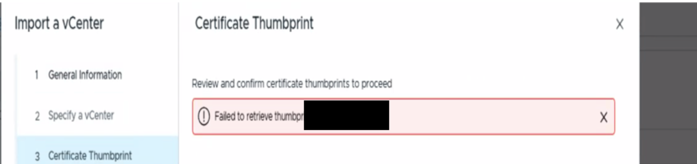

During workload domain import validation in VMware Cloud Foundation, the validation of the target vCenter Server fails with the following error:"“Failed to retrieve thumbprint”:

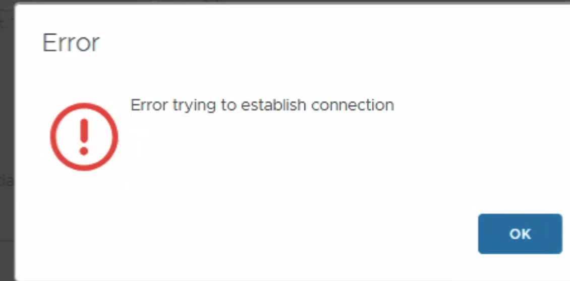

Attempting to add the vCenter integration in VMware Cloud Foundation Operations also fails with "Error trying to establish connection"

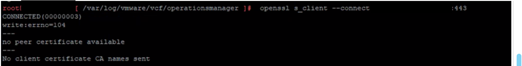

Verifying the connectivity using openssl from SDDC Manager shows connection terminated with write:errno=104.”

Network connectivity problems or security controls interrupt SSL/TLS communication over TCP port 443 between the SDDC Manager and the target vCenter Server.
Engage the Network Team to verify any SSL/TLS inspection policies, firewall rules, or security controls that may be interrupting encrypted communication, and ensure uninterrupted TCP/443 connectivity between the SDDC Manager and the target vCenter Server.
Once SSL/TLS communication is successfully established, retry the vCenter integration or workload domain import operation.
