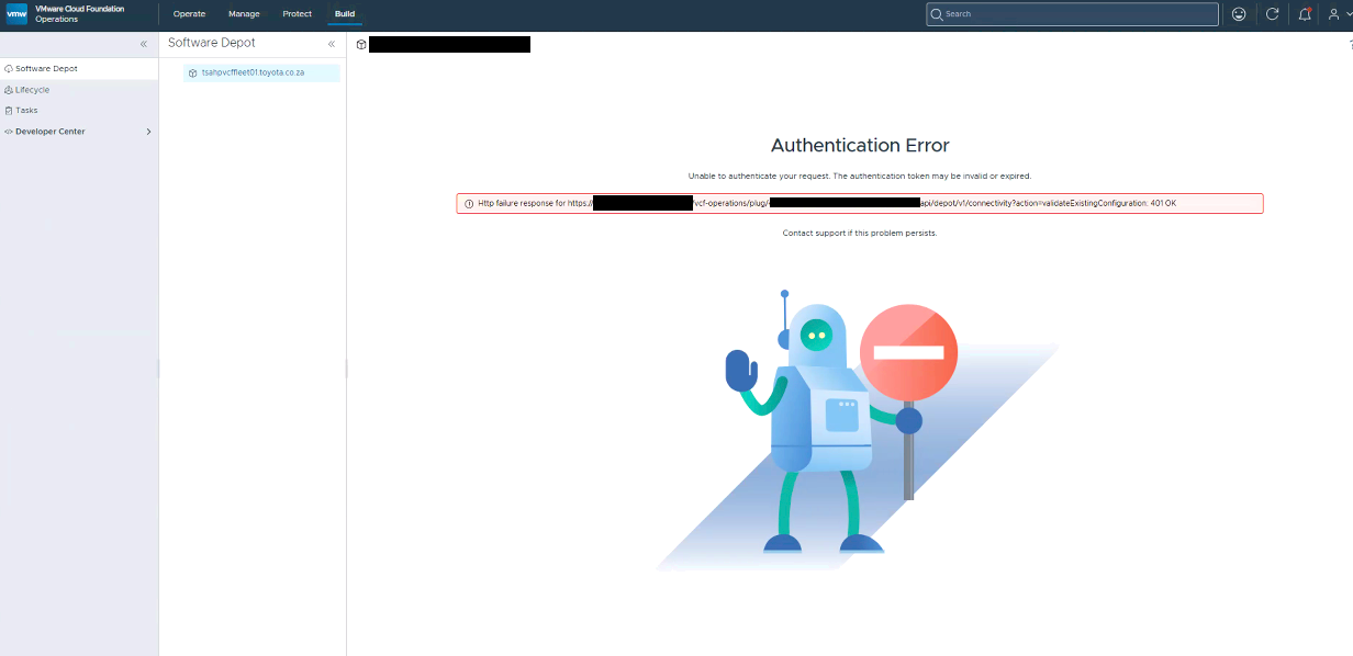

  • When trying to access accessing the Software Depot we seeing the following error:
    Unable to authenticate your request. The authentication token may be invalid or expired
    Http failure response for https://<vcfops_fqdn/vcf-operations/plug/<ID>/api/depot/v1/connectivity?action=validateexistingConfiguration: 401 OK
