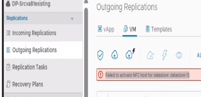

Virtual machine protection tasks fail when initiated from VMware Cloud Director Availability with Error: "Fails to activate NFC Host for datastore"
