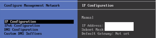

  • Access to the vCenter Server Management Interface (VAMI) or vSphere Client fails following a hardware lifecycle event on the underlying ESXi host.
  • This typically occurs when a motherboard is replaced, causing a mismatch in virtual-to-physical network mappings
  • As shown in the image below, the default gateway value is 'Not Set' on the vCenter
