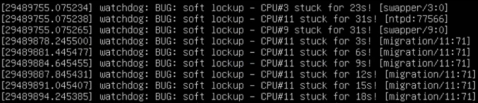

  • A VM console on the affected VM shows the CPU stuck for x seconds messages like in the screenshot below.
  • The following log is observed from the /var/log/kern.log file of the impacted NSX manager VM
    <Time-stamp> <NSX-Manager-hostname> kernel - - - [588###.585###] watchdog: BUG: soft lockup - CPU#20 stuck for 10s! [swapper/1:0]
    <Time-stamp> <NSX-Manager-hostname> kernel - - - [588###.585###] watchdog: BUG: soft lockup - CPU#6 stuck for 9s!
