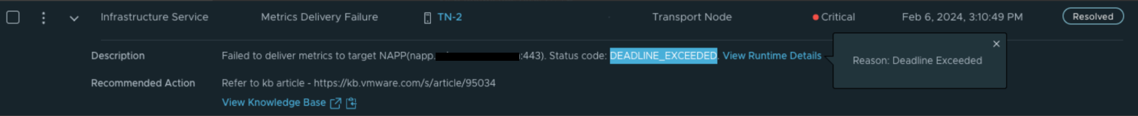

Scenario B: NAPP IS Deployed
If NAPP is actively deployed, you need to identify why the metrics transmission is failing by pulling the specific error status code.
1. Identify the Status Code
  • NSX Build >= 4.2: Look directly at the UI alarm description; the failure status code is highlighted there.
  • NSX Build < 4.2: Identify the "Reported by node" inside the alarm, log into that specific node, and access the logs:
    • NSX Manager / NSX Edge: /var/log/syslog*
    • ESXi Host: /var/run/log/nsx-syslog*
    • Run the following command to find the precise failure block:
      grep "Failed to send one msg" {log_file}
2. Remediation Based on Status Code
Find the respective status code discovered in the step above and apply the relevant workaround:

* Firewall Blockages: Check if a physical/logical firewall between the Transport Node (Edge/ESXi) and NAPP is blocking port HTTPS (443). Reference VMware Ports & Protocols for specifics.
* Target Verification: Run a GET request to /api/v1/infra/sites/napp/registration on the managing NSX Manager. Check if the returned "ingress_ip_address" field matches your {metrics_target_address} and ensure DNS lookup resolves properly on the reporting node.
* Widespread Alerts: If multiple Edges/Hosts show this concurrently, check for an active nsx_application_platform_communication.manager_disconnected alarm and resolve that first.
