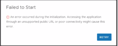

Error "Failed to Start: An error occurred during the initialization" when trying to access UI from individual node
Article ID: 441391
VMware Cloud Director VMware Telco Cloud Infrastructure
  • Load balancer is unavailable
  • UI needs to be accessed from individual cell
  • Error "Failed to Start: An error occurred during the initialization" when trying to access UI from individual node
VCD: 10.3.3.3
TCI: 2.1, 2.2
VCD strictly enforces public endpoint configurations to ensure secure routing and correct generation of internal proxy addresses
These public addresses are pointing to a loadbalancer FQDN which is not available, so when trying to access VCD using a different URL, the redirect, fails
