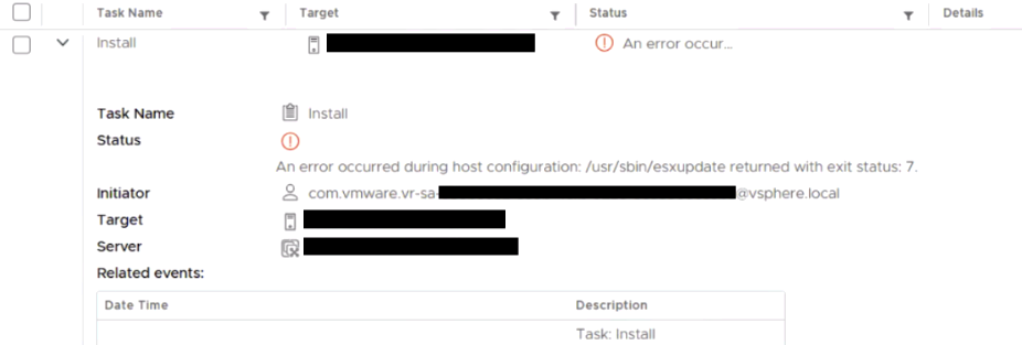

  • Continuous error messages in vCenter tasks for ESXi hosts: An error occurred during host configuration: /usr/sbin/esxupdate returned with exit status: 7.

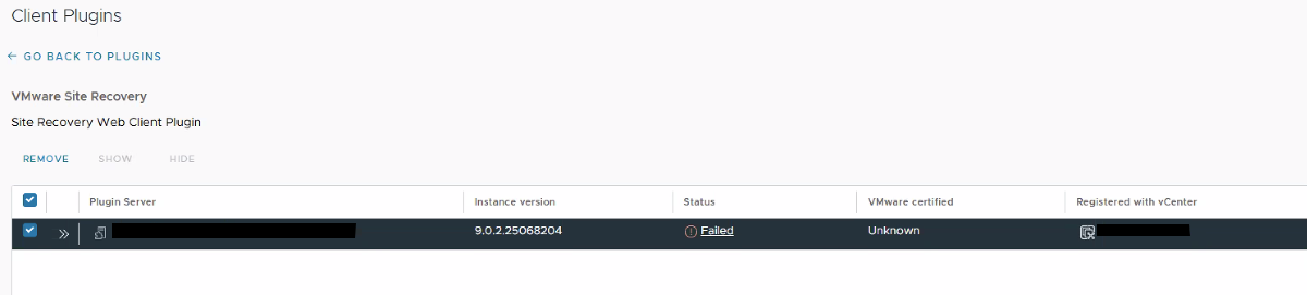

  • The SRM (Site Recovery Manager) client plug-in status shows as Failed.
  • The Site Recovery option is missing from the vCenter main menu.
