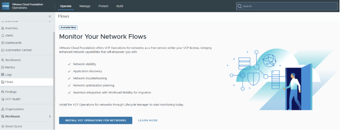

  • Navigating to VCF Operations > Operate > Flows indicates that VCF Operations for Networks is not recognized as installed :

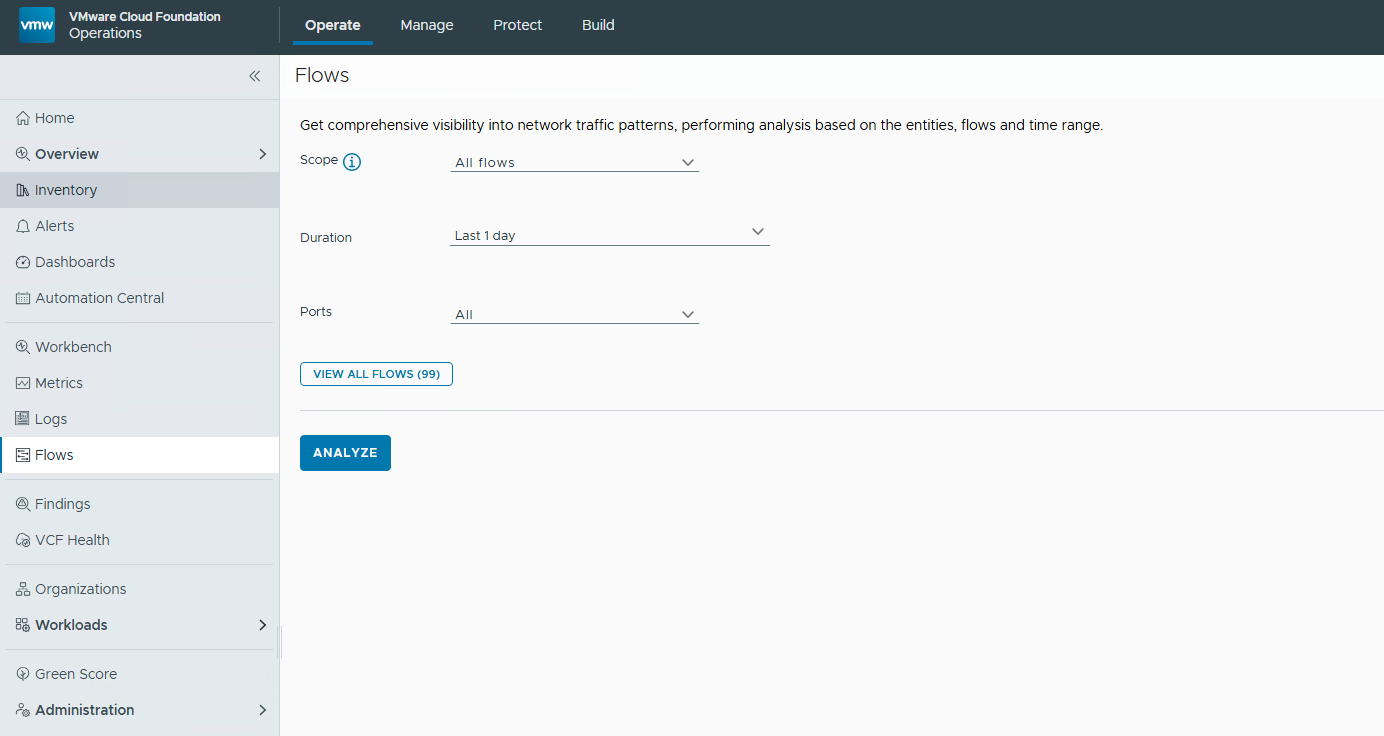

Navigate to VCF Operations > Operate > Flows and confirm that the VCF Operations for Networks deployment is recognized and the Flow Analyze view is visible.
