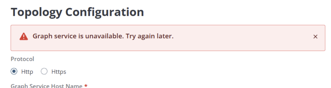

Did a fresh install of Topology.
Users encounter a "Graph service is unavailable" error or an "inventory data failed to synchronize" error when attempting to run a Sync under Topology Configuration in DX NetOps.
the install logs show "Neo4J1" errors like this:

NetOps Topology 25.4.x
New install
Port conflict on port 5000 prior to the install.
See the Topology Prerequisites here:
Deployment Overview of Topology
The customer had another application causing a conflict on pot 5000.  However, they are unable to configure the other application to use a different port.
-Use the following command to remove the failed topology install
ansible-playbook -i inventory -K topology-uninstall.yaml
-After removing Topology, temporarily stop the conflicting application in order to free up port 5000.
-Reinstall Topology
-After the install is complete, change the  Neo4J port by following the steps from the following KB:
How to change the port that the Neo4j service uses after installing the DX NetOps Topology services?
On the ansible host, run the following command to stop the services.
ansible-playbook -i inventory -K provisioning/services_stop.yaml
On the topology host, open the <install_directory>/netops-topology/neo4j/conf/neo4j.conf file and add the below to the bottom of the file:
server.discovery.listen_address=:5001
server.discovery.advertised_address=:5001
Save the file and then run the below command back on the ansible host to start the services.
ansible-playbook -i inventory -K provisioning/services_start.yaml
-Reboot the server and restart the other application that runs on port 5000
