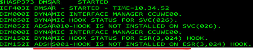

Disk DMSAR hook is not installed
Make sure Disk DMSAR hook is installed by issuing the following command in the syslogs.
/S DMSAR,DMSAR=STATUS
DIM152I ADSHS001-HOOK IS NOT INSTALLED.
If it returns as not installed as shown above, then issue the command to install the DMSAR.
/S DMSAR,DMSAR=INSTALL
After the log shows that DMSAR hook is installed then re-run the job (deleting archived data sets) again.
