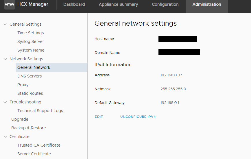

  1. Change the IP address via the HCX Manager Appliance Management interface <https://<hcx-fqdn>:9443> at Administration > Network Settings > General Network.
    Note: Once the IP address is changed, you may need to update the distributed port group for the new network.
