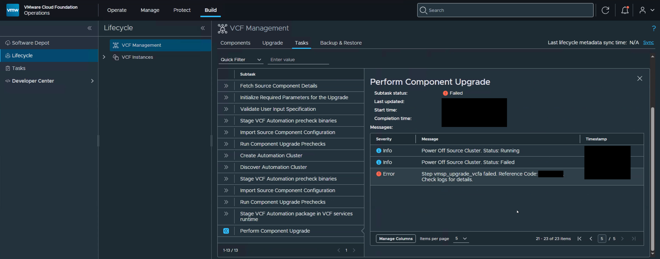

  • VCF Automation upgrade to 9.1 fails during Perform Component Upgrade stage after completing the upgrade pre-checks.
  • You see the following error messages during the failure:
    Power Off Source Cluster. Status: Failed
    Step vmsp_upgrade_vcfa failed.

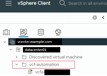

  6. Login to vCenter Server using vSphere Client.
  7. Select the VMs and Templates view.
  8. Search for the VCFA Cluster VMs.
  9. Record the VCFA VM folder path.
    1. In the sample screenshot below, the folder path is datacenter01/vm/vcf-automation
  10. If the folder path is different, relocate the VCFA cluster VMs (drag and drop) the VMs to the folder path configured in VCFA cluster configuration, which is recorded in Step 5 above.
