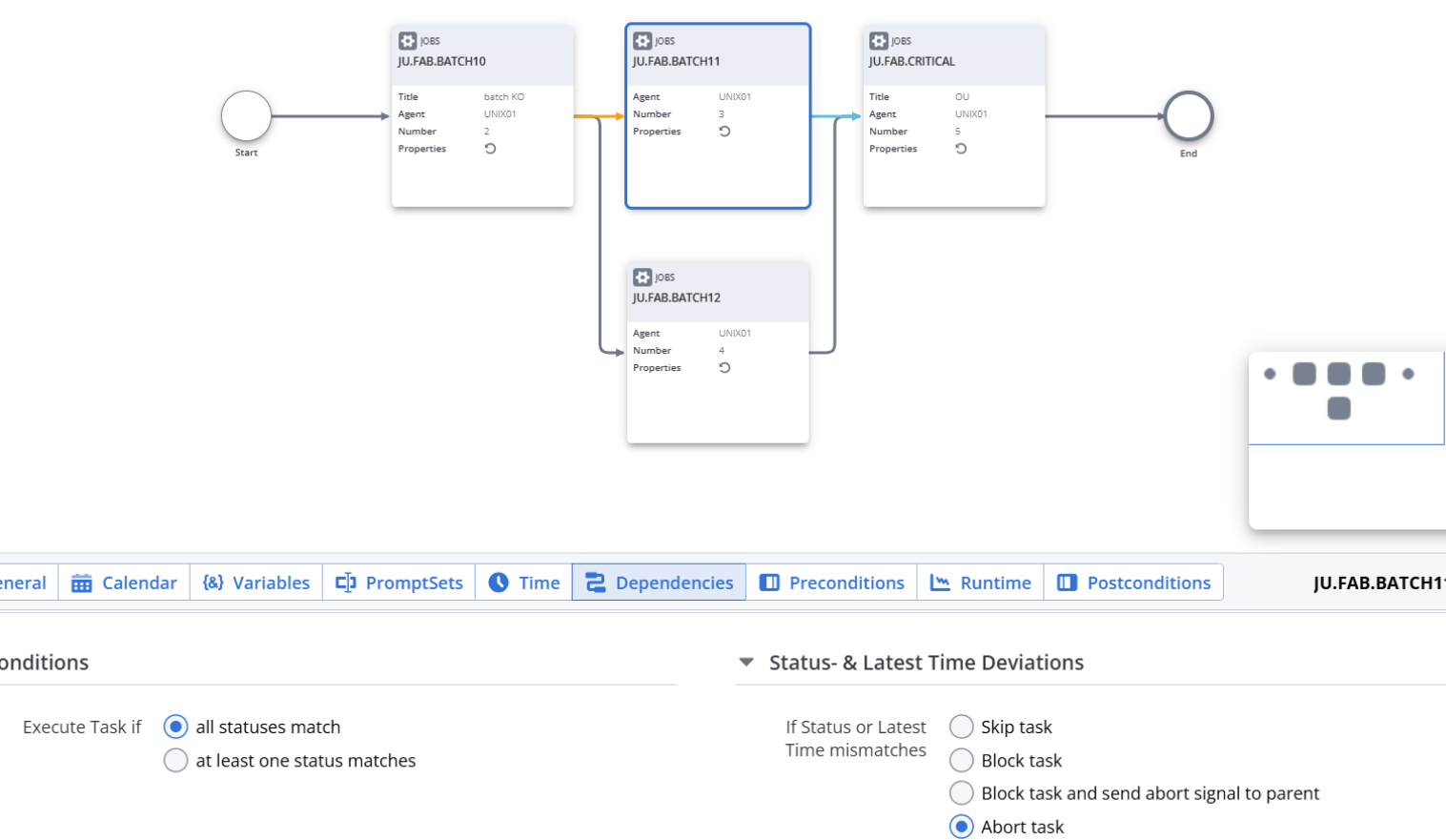

You are working with a Worfklow (JOBP) and notice that the Dependencies are not respected anymore and other  tasks get the status ENDED_JP_ABEND  as soon as one task receives the status ENDED_JP_ABEND due to the fact that you have set "If status or Latest Time mismatches"  Abort task
On the example below, see the Dependencies on JU.FAB.BATCH11 where  Abort task was used

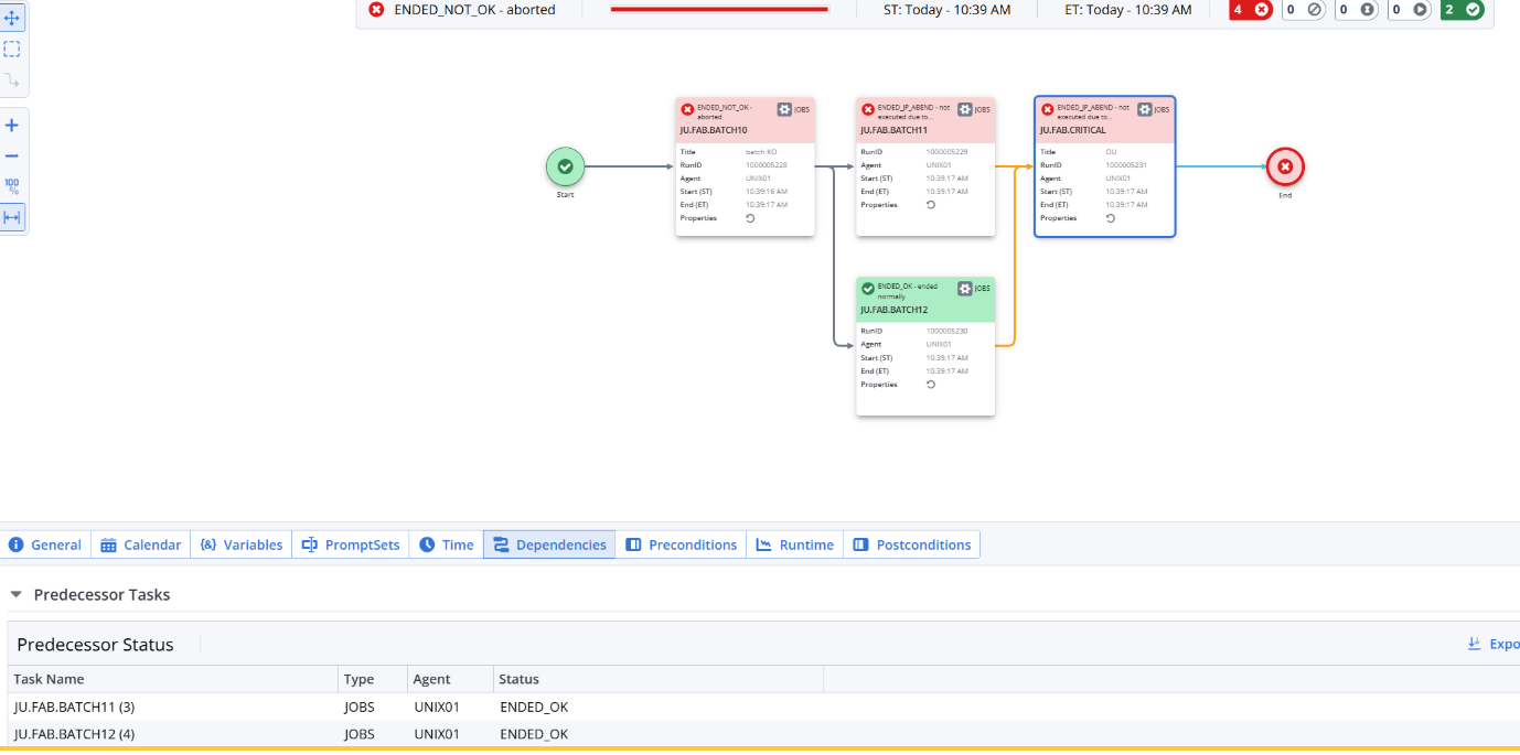

When we execute this JOBP we obtain the following results:
You would have expected that the logic would have been respected and the JU.FAB.CRITICAL would have been executed as the JU.FAB.BATCH12 completed in ENDED_OK, but instead the whole workflow is set to ENDED_NOT_OK - aborted and the JU.FAB.CRITICAL is instead of being executed is set to ENDED_JP_ABEND.
The same occurs with a different test where ANY_ABEND is used and this status ENDED_JP_ABEND is not considered as the whole workflow execution is interrupted.

To achieve the desired behavior where the workflow continues even if a job fails, you must change the dependency action:
  1. Open the Workflow and select the properties of the task (e.g., JU.FAB.BATCH11).
  2. Go to the Dependencies tab.

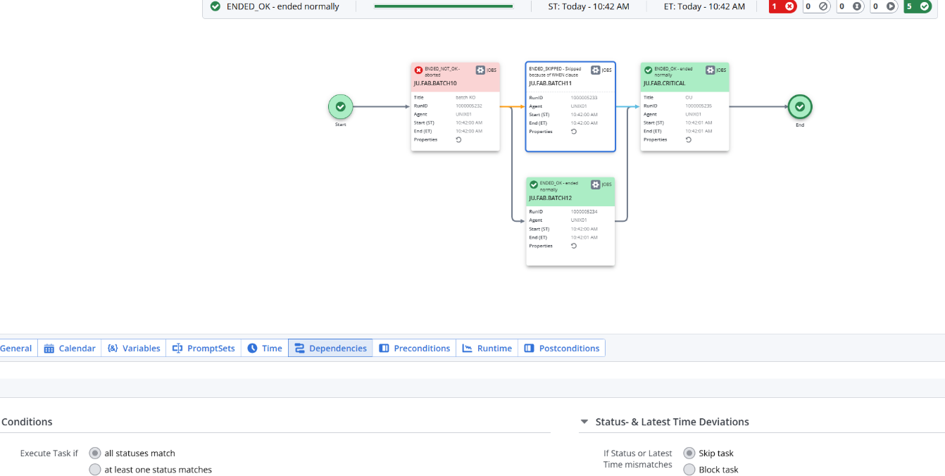

  3. Change the "Else" action from Abort Task to Skip Task.
Why this works: Using Skip Task allows the individual task to fail/skip without propagating an "Abort" signal to the entire Workflow. This keeps the Workflow container active, allowing the engine to evaluate the conditions for JU.FAB.CRITICAL (such as your OR condition) and execute it as expected.
Example of the expected output when Skip task is used:
