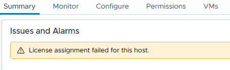

  • After upgrading ESXi hosts to version 9.1, or after a host reboot, the vSphere Client displays a warning banner: License assignment failed for this host.
  • The event type ID com.vmware.license.HostRejectedLicenseEvent is triggered in vCenter.
