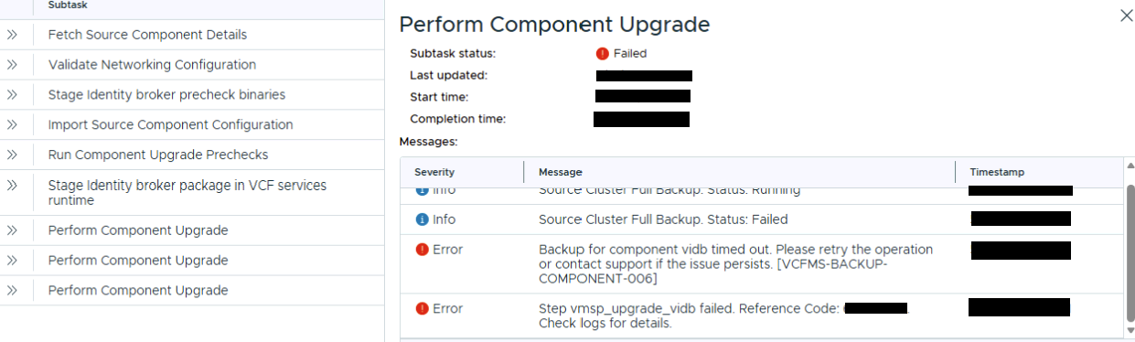

  • VIDB Upgrade failure during Perform Component Upgrade Stage - Source Cluster Full Backup Status: Failed - VCFMS-BACKUP-COMPONENT-006
    Backup for component vidb timed out. Please retry the operation or contact support if the issue persists. [VCFMS-BACKUP-COMPONENT-006]  && Step vmsp_upgrade_vidb failed. Reference Code:####
