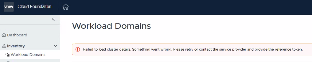

WORKLOAD DOMAINS fails to load in the SDDC Manager with Error: Failed to load cluster details. Something went wrong. Please retry or contact the server provider and provide the reference token.
Article ID: 441160
VCF Operations VMware SDDC Manager / VCF Installer
  • In the VMware Cloud Foundation (VCF) environment, the SDDC Manager dashboard dashboard fails to populate or load the Workload Domain details.
  • A banner notification displays the error message: Failed to load cluster details. Something went wrong. Please retry or contact the server provider and provide the reference token.
  • The Host details view appears entirely empty.

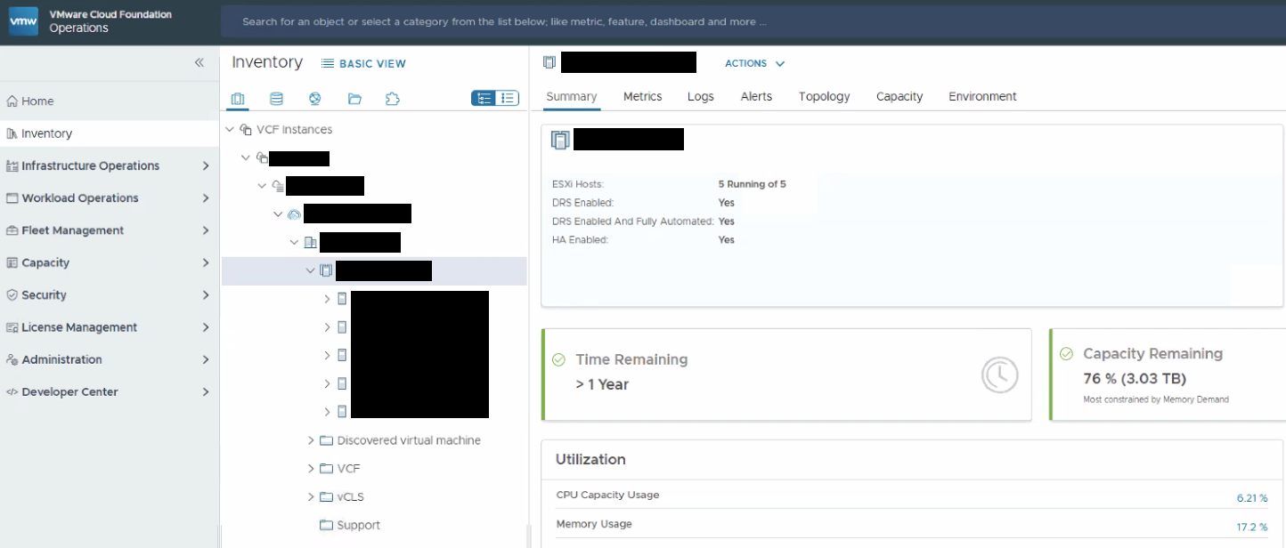

  • The VMware Cloud Foundation (VCF) Operations Manager successfully lists the complete infrastructure topology and inventory.
