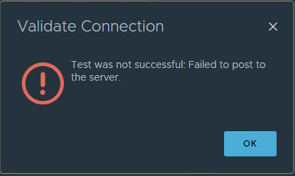

When attempting to configure and validate a GoAlert webhook connection in VMware Aria Operations, the validation fails. One or more of the following symptoms may be observed:
  • The Aria Operations UI displays the error: "Test was not successful: Failed to post the server."
  • Testing the connection directly from the "Aria Operations > Operations > Configurations > Outbound Settings" UI results in "400 Bad Request" HTTP error.
