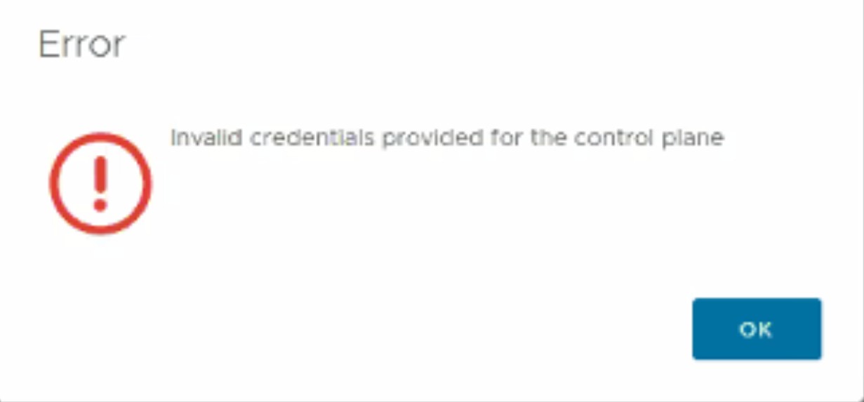

  • When attempting to configure the Kubernetes Adapter the following error is displayed:
VMware Aria Operations 8.18.6
