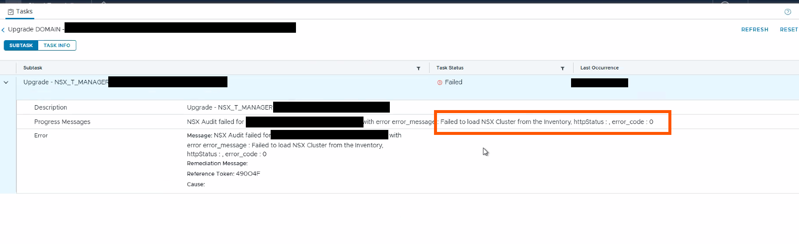

  • When attempting a VMware Cloud Foundation (VCF) lifecycle upgrade, the upgrade process fails during the initial pre-check phase.
  • The SDDC Manager user interface reports that the pre-check has failed because of the error message below :-
    Failed to load NSX Cluster from the Inventory, httpStatus :, error_code : 0

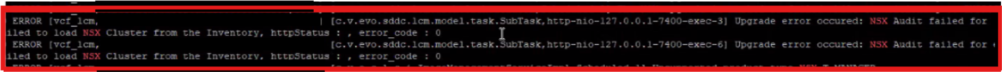

  • On the SDDC manager, the error "Upgrade error occured: NSX Audit failed for <nsx_manager> Failed to load NSX Cluster from the Inventory, httpStatus : , error_code : 0" is recorded in /var/log/vmware/vcf/lcm/lcm.<date>.log-debug.
