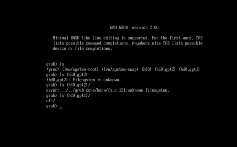

Symptoms:
  • Virtual machines halt at the GRUB prompt.
  • A black screen appears with a blinking cursor at the GRUB stage.
  • The virtual machine's /vmfs/volumes/datastore_name/vm_name/vmware.log file shows no disk or hardware errors.
  • Virtual disks are mounted and network-connected at the ESXi level, but the boot process does not progress.
