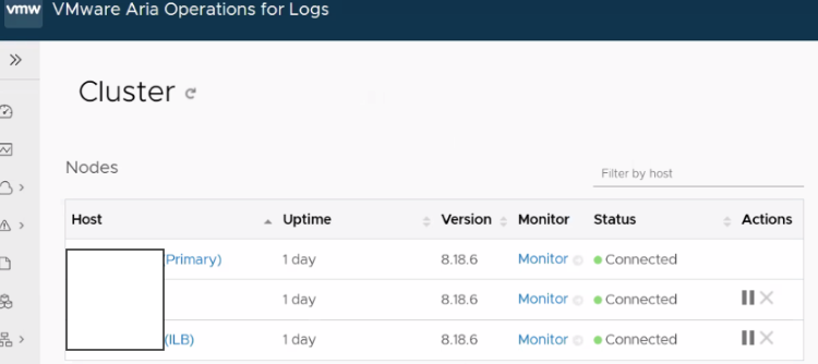

During the Aria Operations for Logs deployment, Operations for Logs Worker Node gets bootstrapped.
It signifies that the application services are active and the node has moved beyond its "first-boot" or factory-reset deployment phase. Hence its unable to receive any further configuration from the Primary node during the cluster join process.
If Aria Operations for Logs Primary and Worker nodes are successfully deployed then you can either import the existing environment in the Aria Suite Lifecycle or Redeploy the same environment.

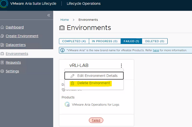

If you don't want to import the existing Aria Operations for Logs Environment in Aria Suite Lifecycle Manager, follow below steps to redeploy the Aria operations for Logs environment:
- Shutdown existing Master and Worker nodes
- Disconnected the Master and Worker Node VMs from network (using VM Edit settings in vSphere Client)
- Rename Master and Worker Node VMs to "-OLD" using vSphere Client
- Delete the FAILED Aria Operations for Logs Environment from Aria Suite Lifecycle Manager
- Now, proceed creating the new Aria Operations for Logs Environment with same configuration in Aria Suite Lifecycle Manager and monitor the deployment progress.
