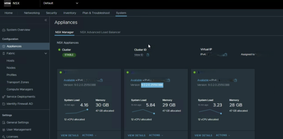

NSX Manager Status
SSP 5.1.1

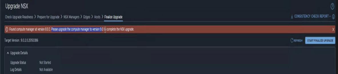

- SSP NSX-manager- readiness 'not ready'  and Infra and Inventory  'unknown' state are caused by an incomplete NSX upgrade. Specifically, the NSX environment is stuck in a pending state because the compute upgrade has not been finalized.
Example
To resolve this issue and restore the NSX-manager readiness status in the SSP UI, finalize the NSX upgrade.
  • Log in to the NSX Manager UI.
  • Navigate to System > Upgrade.
  • Complete the process by executing the Finalize Upgrade step.
Once the upgrade is fully finalized, the NSX-manager readiness status will update to "Up" in SSP.
For step-by-step guidance on this process, please refer to the official documentation: Finalize the NSX Upgrade.
