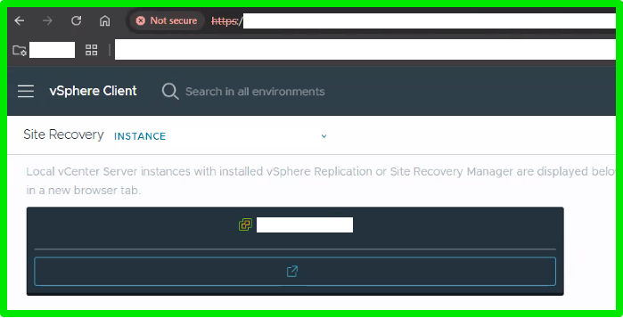

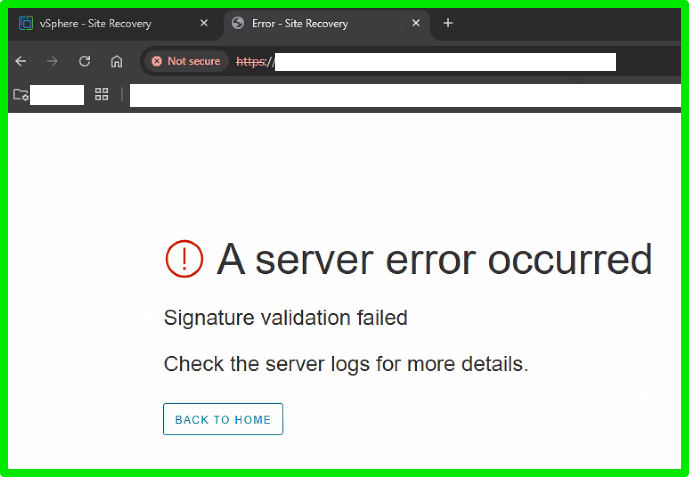

The Site Recovery Manager (SRM) user interface intermittently becomes unreachable, and the remote plugin displays in a distorted or corrupted state within the vSphere Client. Attempts to access the Site Recovery interface or log in via WebSSO fail with an explicit validation error: "A server error occurred. Signature validation failed. Check the server logs for more details."
Accessing VLR UI manually displays this error.
You cannot access the VLR UI from vCenter because the plugin in corrupted.

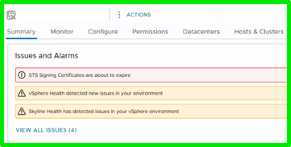

vCenter displays an alarm regarding STS Certificates.

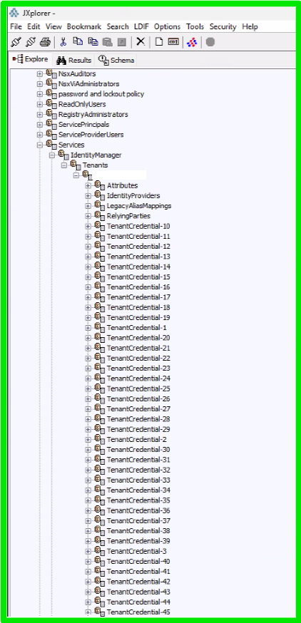

You find numerous TenantCredential Certs in JXplorer.

A significant accumulation of duplicate, stale, or expired Security Token Service (STS) signing certificates within the vCenter Single Sign-On (SSO) VMDIR database leads to this issue. This certificate bloat corrupts the token validation path for external solution extensions.

  1. vCenter Management will use directory management tools (such as JXplorer or internal CLI utilities) to connect to the VMDIR LDAP node (dc=vsphere,dc=local) and safely remove the extraneous TenantCredential-X and TrustedCertificateChains-X entries.
