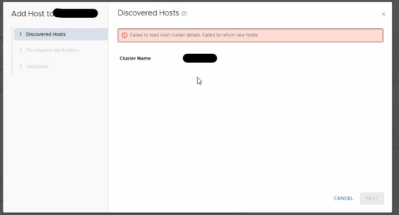

  • In SDDC manager GUI one sees:
    • Failed to load Host cluster details.  Failed to return new hosts.
  • Adding a new host to a VxRail cluster via SDDC Manager fails the "Add Host to Cluster", but there is not task in SDDC manager because this issue is before SDDC manager fully engages and is at the VxRail step.
  • The task may show a generic failure in the SDDC Manager UI, or an "Inventory version synchronization" warning.

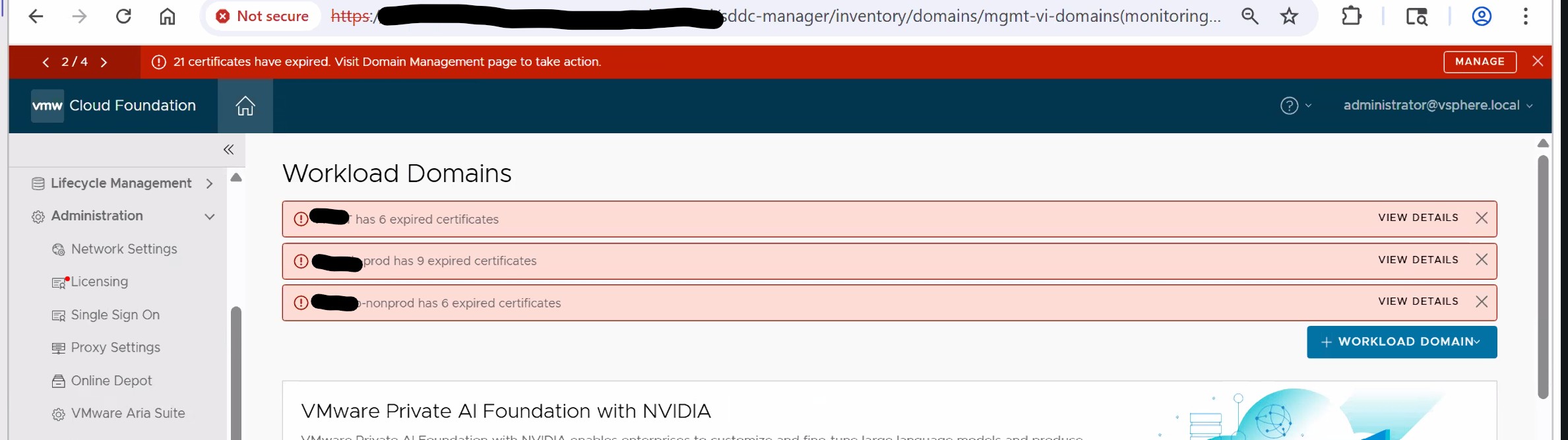

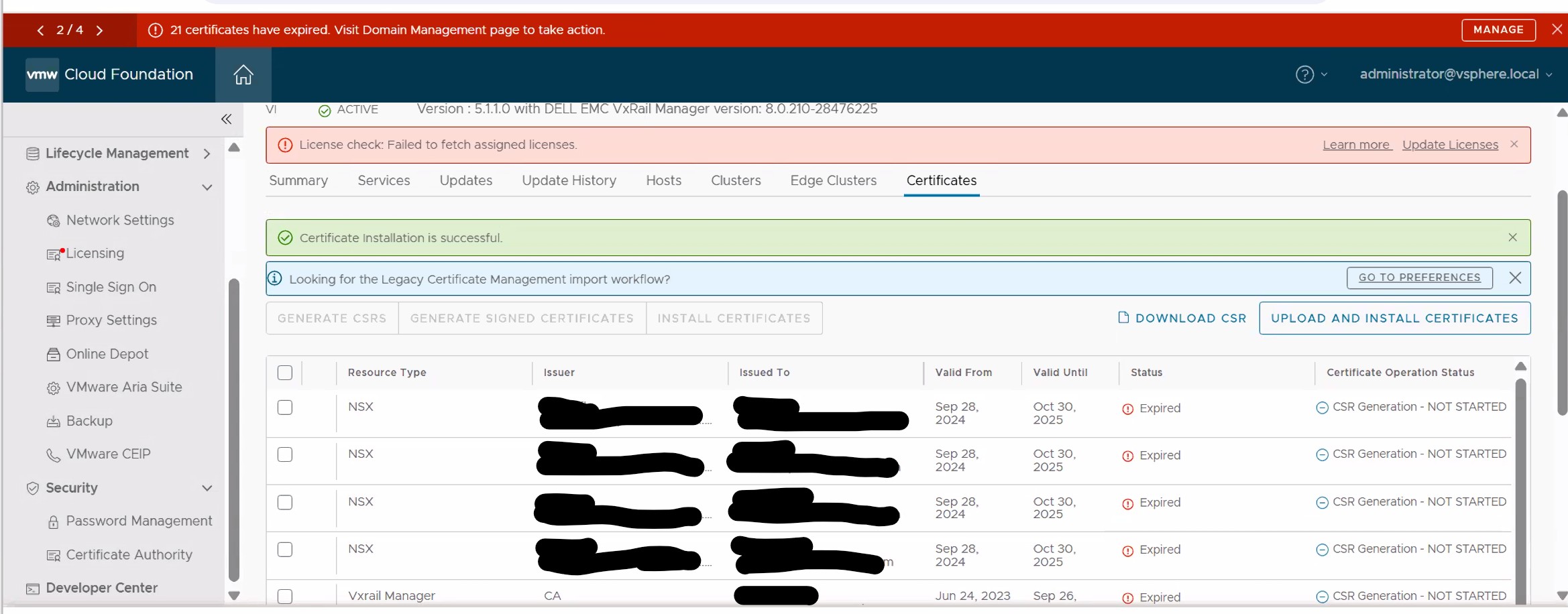

  • The certificates show as expired in the SDDC manager GUI:
    • Domain name has ## expired certificates
    • Certificate manager in SDDC manager GUI shows VxRail Manager certificate to be expired
