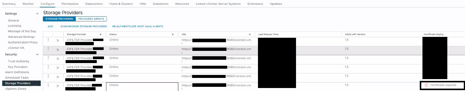

  2. Select the vCenter Server in the inventory and navigate to vCenter Sever > Configure > Storage Providers.
  3. Review the Certificate Expiry column to locate the expired provider.

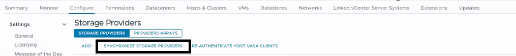

  4. Select the expired vSAN VASA storage provider and click the Synchronize Storage Providers icon.
  5. If synchronization fails, manually remove the provider to force the generation of a new certificate:

  6. Verify the Certificate Expiry column now displays a valid future date.
