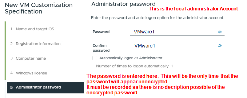

The password configured in the New VM Customization Specification is forgotten or Unknown.

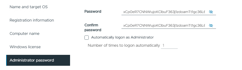

When inspecting there configured password it is seen as a hashed version of what was entered. The password as entered during the configuration of the VM Custom Specification .
The password after saving the configuration is now seen in the hashed form from this point on.

In vCenter Server 8.0, Virtual Machine Customization Specifications (CustSpecs) utilize a multi-layered cryptographic approach to secure sensitive guest OS credentials. When a password is entered into a CustSpec via the vSphere Client or API, it undergoes Data Encipherment before being committed to the database.
Guest OS passwords defined within CustSpecs are strictly prohibited from being stored in plaintext within vPostgres.
The password is only decrypted as part of the guest OS customization phase of the virtual machine deployment process.
There is no method for decrypting the current unknown password.
Edit the New VM Customization Specification with a new password.
This will only affect new deployments. Existing VMs will not be affected.
This password is only used for the local administrator account of the deploying VM.
Existing virtual machines will need to have their local administrator account password recovered using methods common to the OS vendor's recommendations.
If the password is not recoverable then a redeployment of the VM will be needed.
