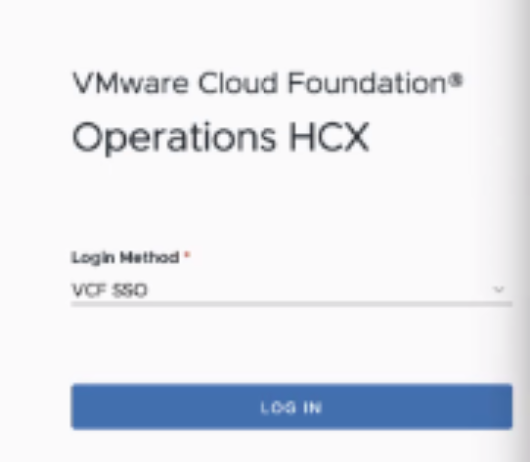

  • Logging into the HCX manager UI port 443 via VCF SSO integrated, displays the following error=following error message:
        "Authentication failed with ViDB OIDC AuthCode"
