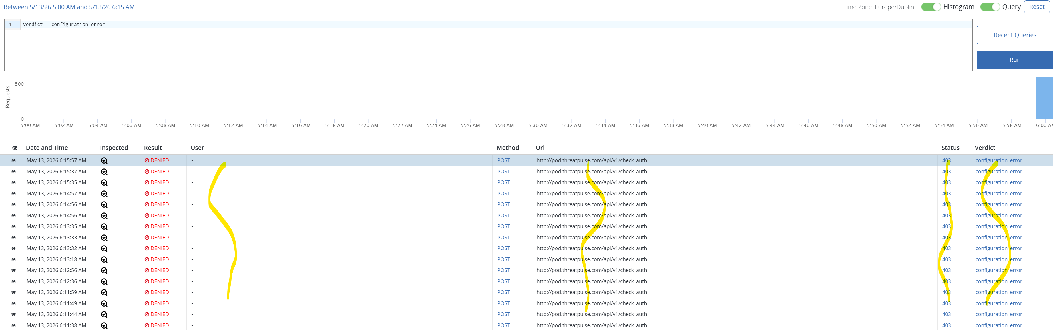

Event viewer log entries for each failing host would show a "configuration_error" verdict going to http://pod.threatpulse.com as shown below:

Support did manage to get a policy trace when the issue happened and confirmed that the reason was an invalid certificate had been found.

Armed with this information, a check of the Entra and Cloud SWG signing certificate was performed where a difference was seen.
