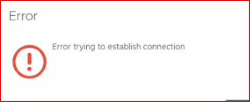

  • Validation error: Attempts to validate the connection between Aria Operations and the vCenter Server / NSX manager are failing with connection timeout errors.
  • Error trying to establish connection when attempting to validate the connection between Aria Operations and the vCenter Server or NSX Manager if the Aria Operations VM is on an NSX segment.

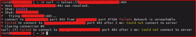

  • Failed to connect to port 443 between Aria Operations and the vCenter Server/NSX Manager. Refer to the details below:
VMware NSX
VMware vCenter Server
This issue occurs because the connection impacted at the Tier-0 (T0) Gateway, as the physical router (ACI) is not advertising the routes necessary to facilitate communication.
Review the routing on the Tier-0 Gateway and ensure that the appropriate routing configurations are being advertised from the ACI (physical network) to allow traffic to reach the Aria Operations environment.
